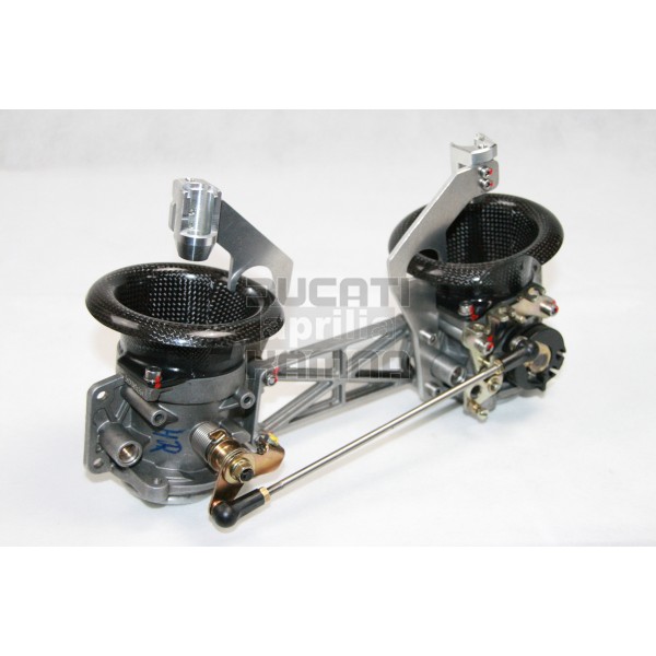

Je me tate à changer l'injection du 999s en 54 par un en 58 mm.
http://www.ducati-kaemna.com/58mm-einspritzbruecke-749-999-bi-s-r-testastretta-at-austausch.html
+6 à 10 cv, cela laisse rêveur.
Quelqu'un à un retour sur ce type de modification?
Réponse #67 le:
novembre 23, 2017, 09:15:42 »
Réponse de CJS à un post de Pimouss sur DUCATI MS.
"Forget the larger fancy 58mm throttle bodies . They dont give anything unless you have a cam with serious lift and valve size !
Forget large air runners . Unless your spinning to 13k and again with serious lift and valve size you wont gain anything.
Go for stock throttle bodies with bursi intake stacks or try the stacks from DM mechannica.
749r cams offer 4-6 hp over S cams depending on final spec. Stroke plays no part in how well these cams work. Remember 999r 05 up and 749r have different strokes but share the same cam profiles.
Longer con rods improve top end hp and delivery , also reducing piston sideloading."
Bon reste à trouver une injection de R ou des Cornet Bursi ou DM mechannica.
